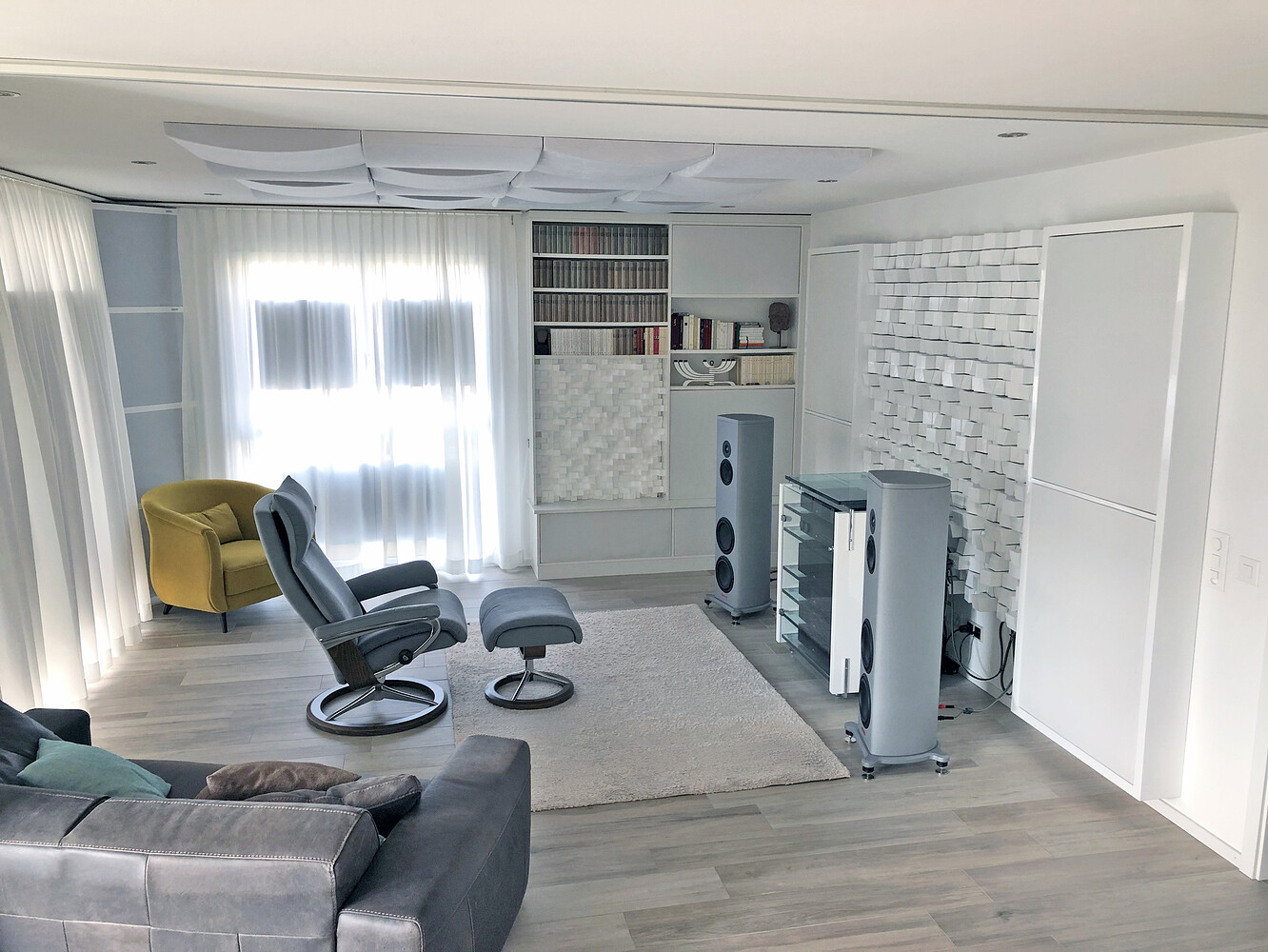

alors non je n'ai pas personnellement utilisé, mais sur des forums hifi pas mal en utilisent avec succès
notamment Thomas, un suisse avec de la grosse artillerie hifi

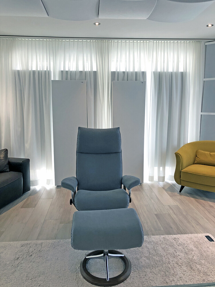

Foam absorbers behind the speakers have been replaced by four GIK Monster Bass Traps (with membrane tech) for maximum lower frequencies absorption, while absorbing less mids and highs. The bass traps are inserted in a glossy white frame that matches the diffusers between the speakers.
Have been testing placing two additional GIK Monster Bass Traps against the back windows with great results (for a total of 6 big GIK Monster Bass Traps against the windows). Those two bass traps were originally place on the right side. There is still a 180 cm x 60 cm on the right side not shown on the pictures.
On the left side, inserted in the book shelves, a series of really thick GIK Monster Bass Traps (from 19,5 cm to 28 cm thick) for maximum low frequencies absorption.
The curtains are highly absorbing veils (a swiss product, that provides an unexpected level of absorption while letting the day light in).
