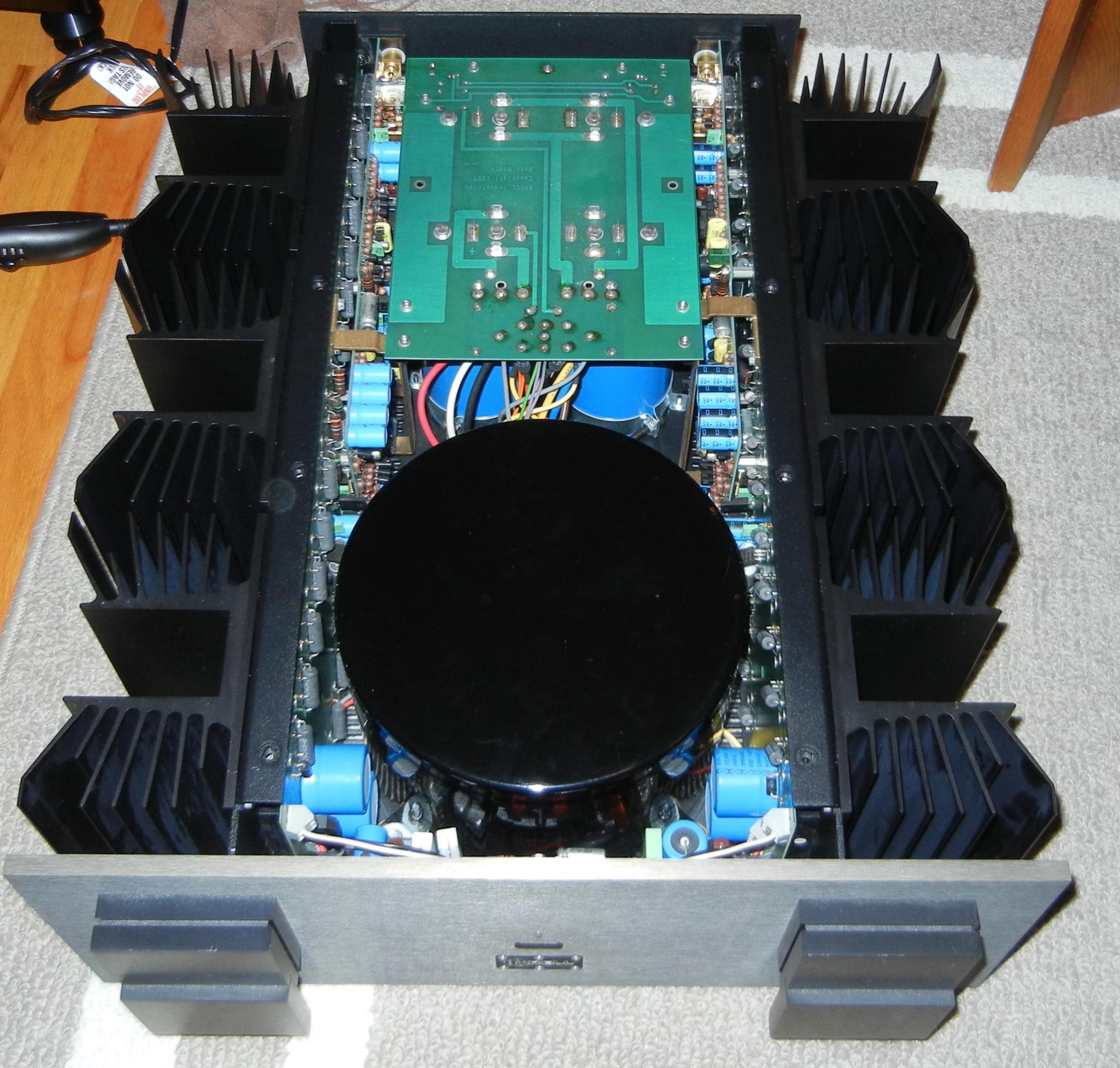

Souvenirs, souvenirs...
Gryphon Essence
Accuphase A75
Krell KSA 250
Krell KSA50
Mark Levinson ML2
Pass Aleph 3
Musical Fidelity A1
SONY TANR1
