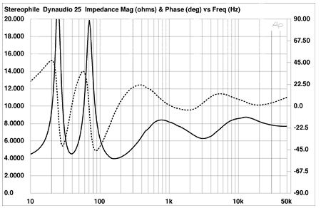

A propos des special 25:
I estimated the Special Twenty-Five's voltage sensitivity at 89.3dB(B)/2.83V/m, 1dB higher than the specified 88dB. The speaker is specified as a 4 ohm load, but as its impedance plot (fig.1) reveals, it drops to this figure for only a small range of frequencies in the lower midrange. The impedance actually stays above 6 ohms for most of the audioband, which, in conjunction with the generally modest electrical phase angle and the higher-than-average sensitivity, suggests that the Special Twenty-Five is a fairly easy amplifier load.
Read more at http://www.stereophile.com/content/dyna ... RDU8gFC.99
Mais les contour 1.3SE:
Sensitivity is given as 85dB/2.83V/1m, with a nominal impedance of 6 ohms. I would not suggest pairing these speakers with tiny single-ended triodes—not with that low 85dB sensitivity. Yes, I tried it. As expected, the speakers died—just didn't come to life.
Read more at http://www.stereophile.com/content/dyna ... OwPfd8h.99

Message #18 par Xkss » 02 Déc 2016 à 14:58
http://www.soundandvision.com/content/d ... asurements
@ jpg, pas évident la mesure du rendement...dans le lien ci dessus il mesure 87db!?
